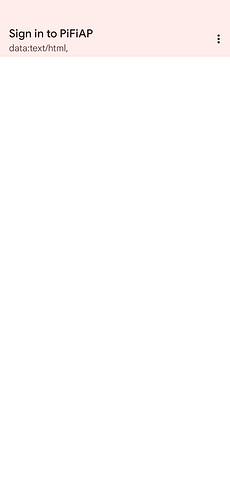

So finally got the Pi5 working. Initial testing is going well, but ran into a snag with a captive portal. Note, This same captive portal works fine with the Pi4 image. The flow is improved over earlier versions as I get the Sign into network, which is encouraging. The issue is when I tap sign in to network I get a blank page. See screenshot. Gli.Net routers also use OpenWrt and have a feature where one can use their device, say a phone to log into the captive portal and then do a mac clone to the Client interface on the router. I’ve been researching this extensively and it seems to work pretty well. Is is possible to add this feature to the app? It would be helpful to have this feature available for those more challenging captive portals.

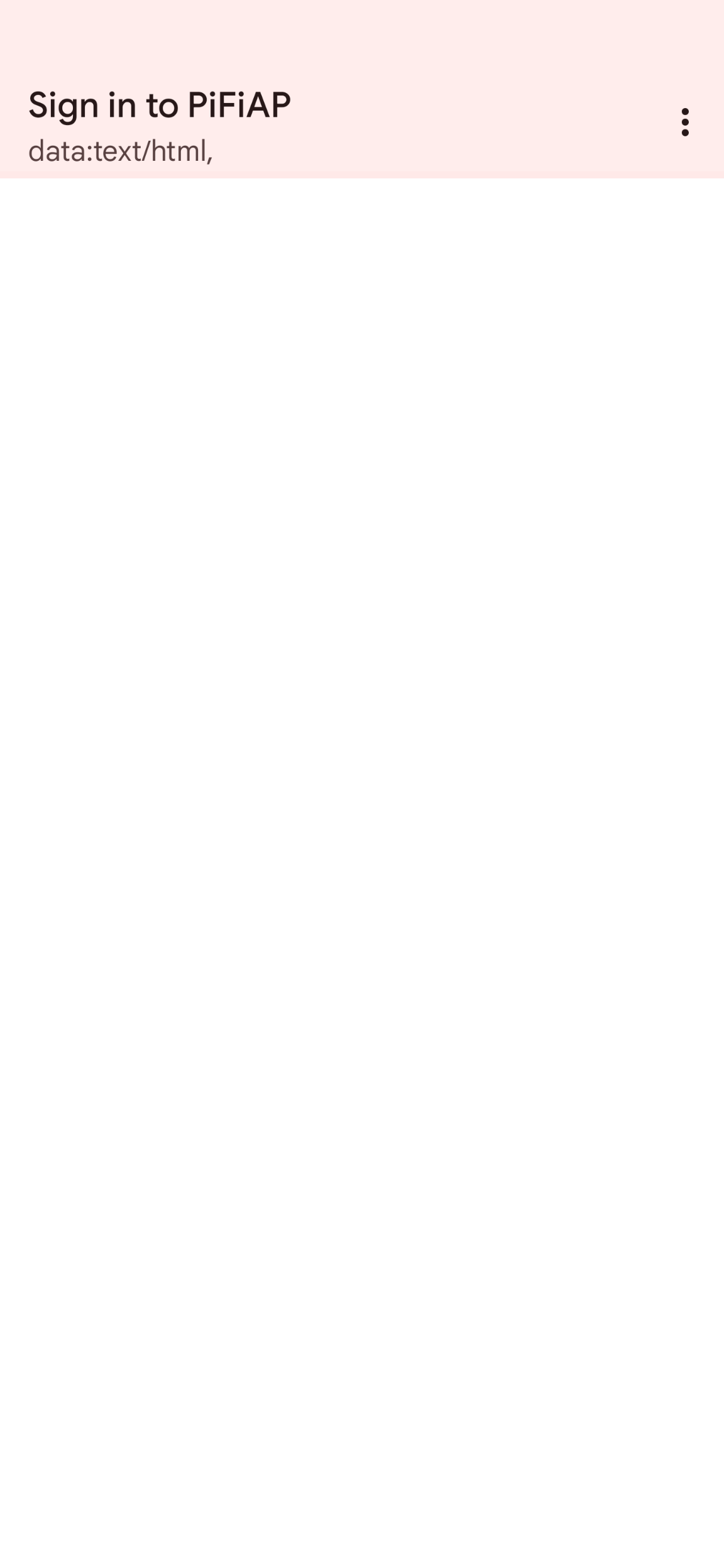

I mistakenly had adguard enabled for initial test. I disabled adguard hoping it would then let me sign in to the portal, but got same blank page. I navigate to http://neverssl.com which triggers the sign in to network, but then still get the blank page.
Can you confirm whether you’re on firmware 1.5.21 or 1.5.20 on the Pi 5? You can check under Settings > More > System Report, then look for Firmware Version.
Also, does a reboot resolve the issue? A reboot shouldn’t be necessary, but I’m wondering if the network hasn’t fully reset to apply the settings.
I’m currently working on new app and firmware builds, so I’ll be testing more on the Pi 5 specifically to catch any quirks with the latest versions. Knowing if a reboot fixes things would help narrow it down.

Firware Version 1.5.21.
Unsure if a reboot works or not as I had shut down the router before I received your response. However, I did boot up the router this morning. I connect to the same network and no portal which is expected until I navigate to a page. I navigate to http://neverssl.com and voila’ up comes the captive portal page.
So it wasn’t a reboot per se, but I did start the router again today so unsure how much this helps. I plan on also doing further testing at various locations around town and will report back.

More test results. Was at the SAP office tonight and tested the Pifi. Initially, could not get it to work. I can confirm that after a reboot I was able to authenticate with their captive portal. The reboot seems to do the trick. As you mentioned previously it shouldn’t be necessary, but for now it is. Hope this is helpful.
It is helpful thank-you!
Because there is a slightly newer OpenWrt version on Pi 5 (24.10 vs 23.05) there must be a subtle difference in how it’s being applied - maybe even be fixable via app change (but will figure it out)
