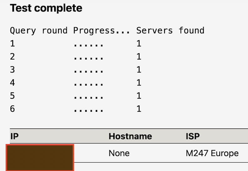

Thanks so much for the quick fix. You’re awesome. Are you aware of obtanium? It was recommended to me by the devs of one of my other open source apps. I have been using obtanium for some time and it’s fantastic. I love getting my app and updates directly from the source. Please consider adding PiFi app here which makes it really easy to add to obtanium. However, most Apps can be added easily to Obtainium by pasting the source link directly into Obtainium’s “Add App” page. If you can please provide the source link I can add it and get the update now without waiting on the app store approval. Thanks so much!
Tested with adguard enabled and DNS working perfectly. :smile:
