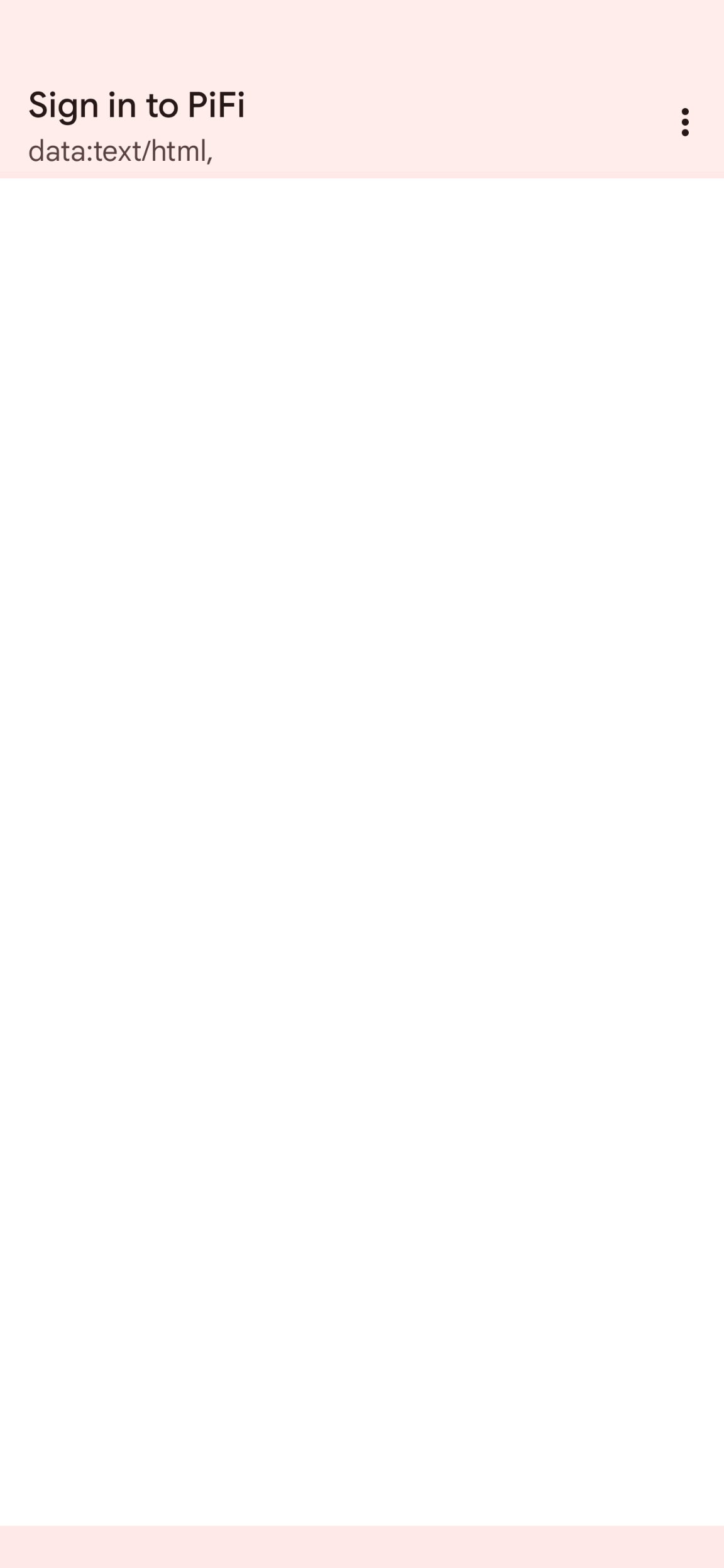

This morning I flashed 1.5.2 beta on a new SD card. When initially setting up Pifi, and I connect to PiFi network it says connected, no internet. Perfect. I then connect to my home Wifi network. Works great. I can go back and forth between my home Wifi and Pifi. Then to test I change the network AP to xfinity hotspot. Pifi connects, but the captive portal fails. I get a message on my phone that I need to sign in. This is expected and good. When I tap on it, I just get a blank page. Now, I try to connect to Pifi and rather than saying Connected, no internet, it tries to Obtain an IP address and continually fails. At this point I’m locked out of Pifi app because I cannot connect to the Pifi network. No tailscale scripts run. Just stock firmware. Hope this helps.

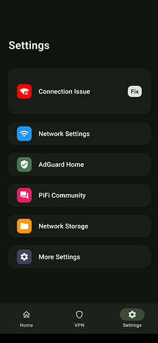

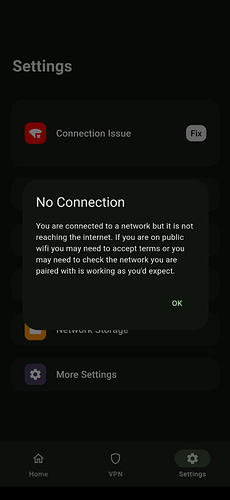

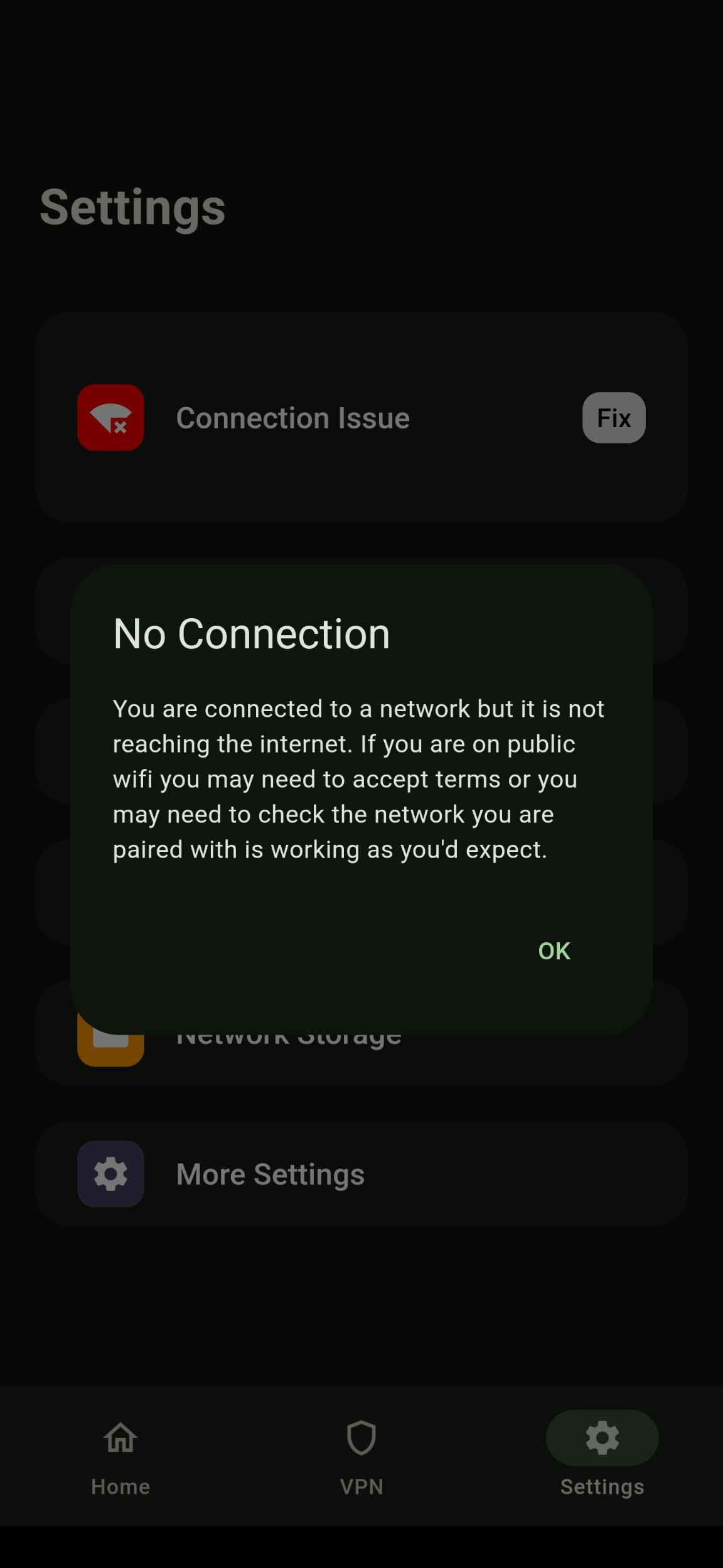

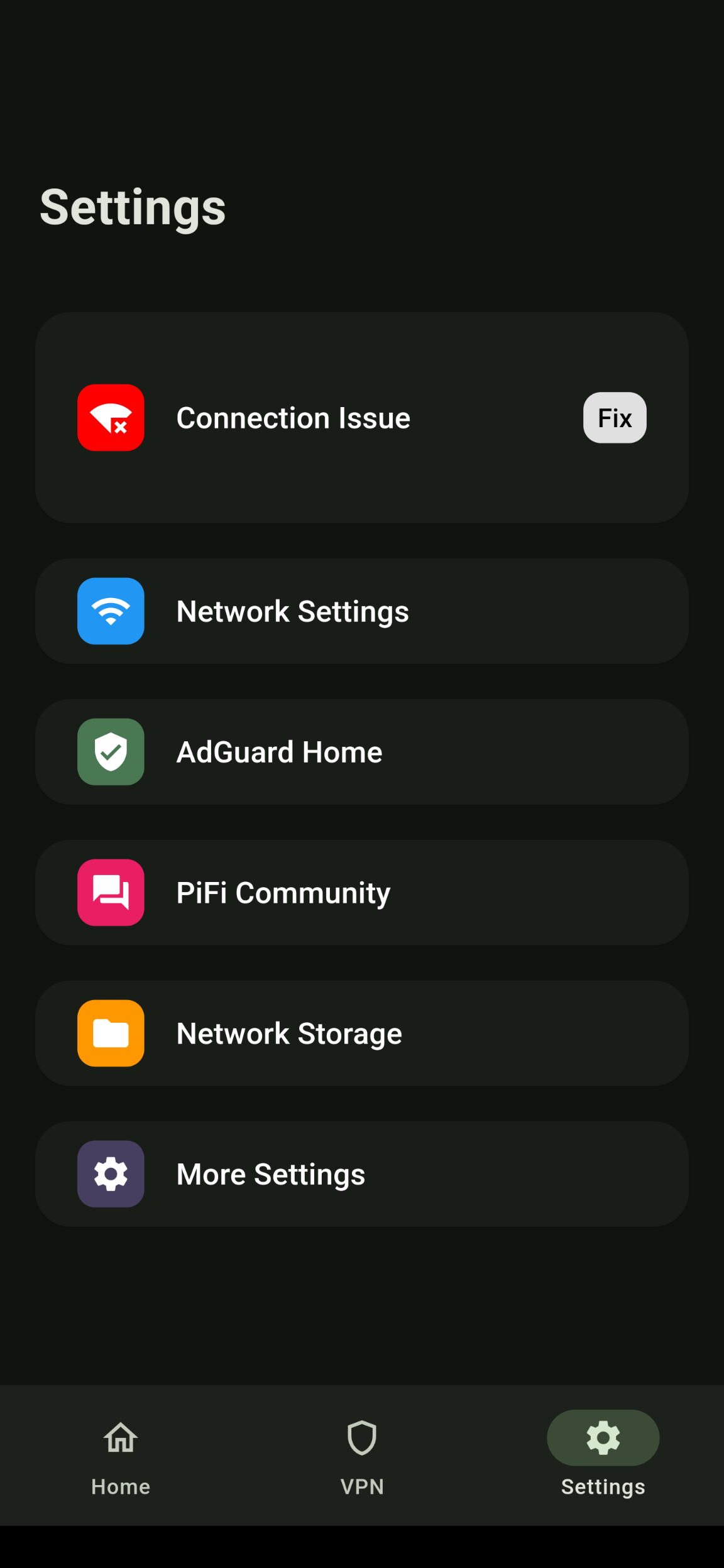

So I did a fresh image on my Pi4, no tailscale. Clean image downloaded from your website. Presently, the Pi4 experience is far superior to the Pi5.
I can always connect to PiFi regardless of valid AP or not. It shows nice friendly messages to alert me to the status. See attached.
It also handles the xfinity captive portal perfectly. The Pi5 just shows a blank page. I will continue to use the Pi4 until the Pi5 experience improves.
