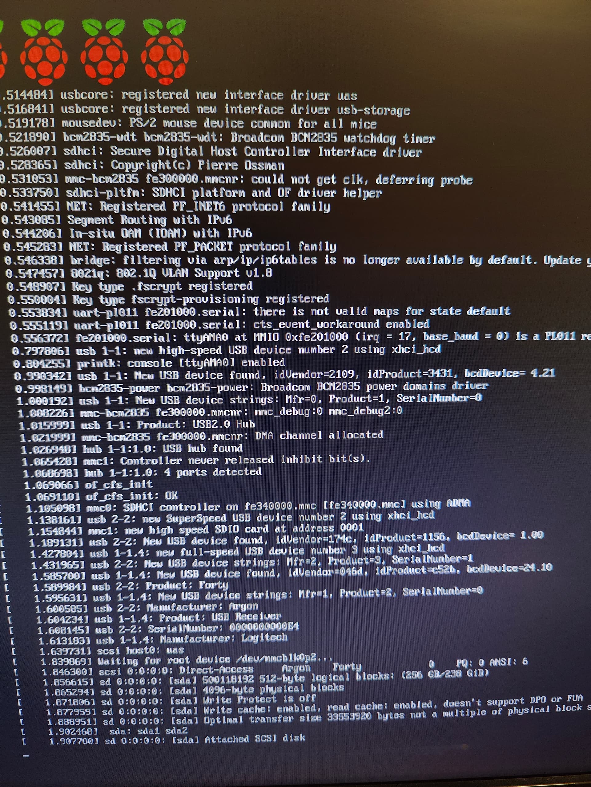

I flashed standard raspbian with GUI on the SD card first, then from the UI that loaded I flashed PiFi (Pi4 with 8GB RAM).
It then won’t boot. This is what I got:

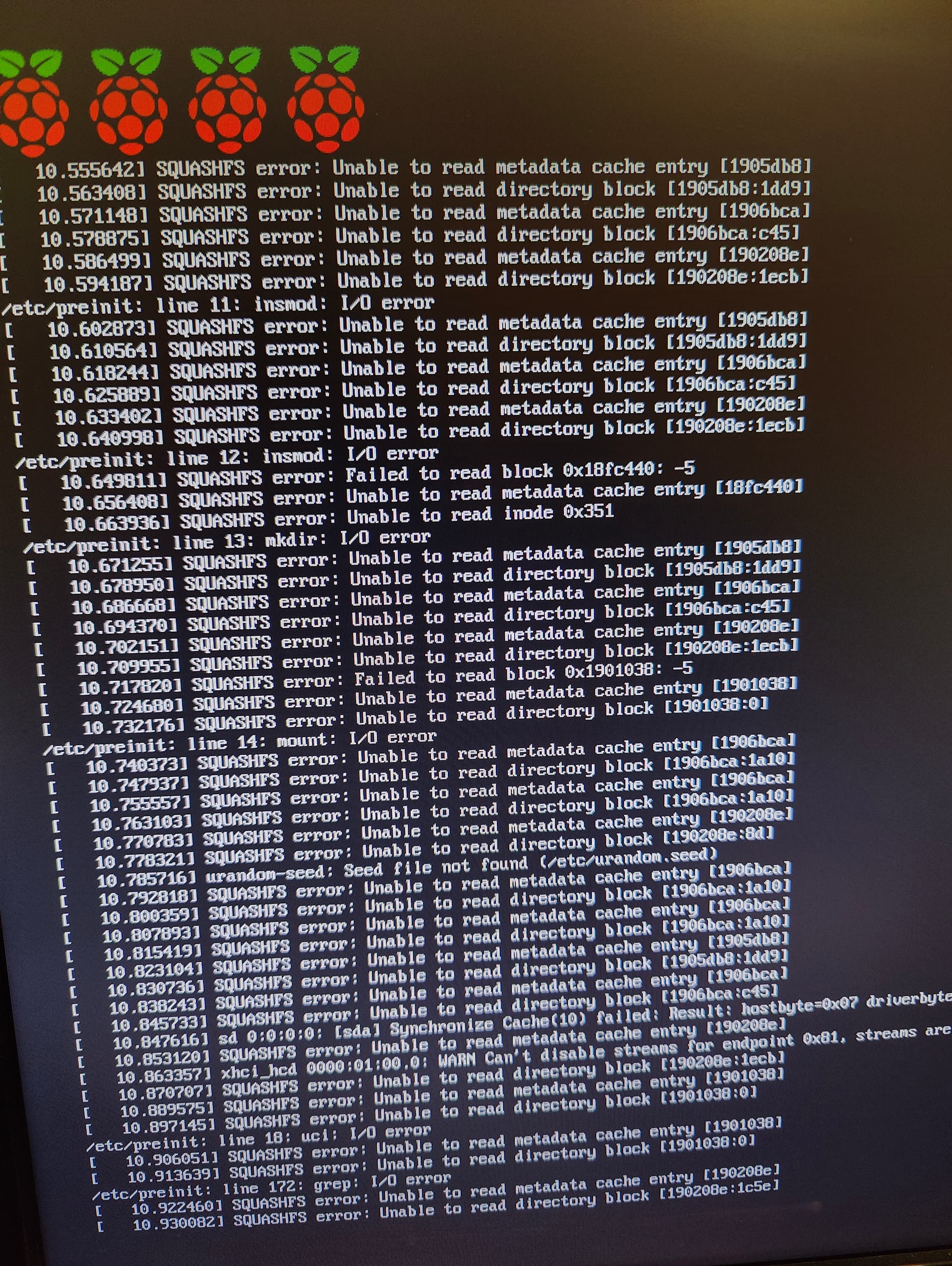

I then applied the tweak suggested in this post:
And now I get another error:
So maybe a different tweak is needed?

I found some things on Raspberry Pi forums (here and here) that may prove useful on this issue. I’d copy the line below rather than the one suggested in the forum.
Can you try cmdline.txt as
usb-storage.quirks=174c:1156:u console=serial0,115200 console=tty1 root=/dev/sda2 rootfstype=squashfs,ext4 rootwait
If that doesn’t work can you try a USB 2.0 port on the Pi rather than USB 3.0 and see if same issue persists?
First, on the Argon SSD case you can’t switch to the USB 2.0, it’s connected to the USB 3.0 in a way that cannot be changed.
However, I made some progress. It was stupid really, I spent so much time on it that I didn’t try the obvious. For some reason adding that line to the cmdline.txt and restarting doesn’t work, but turning off the power completely and turning it back on did work (with the this text in the file: console=serial0,115200 console=tty1 root=/dev/sda2 rootfstype=squashfs,ext4 rootwait)

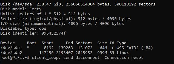

Now I have a different issue, hopefully smaller one. Now that I’m booting from the SSD and running the OS from it, how do I expand the partition to fill up the entire space? I now seem to have 2 partitions - sda1 that’s 64MB and sda2 that’s 1GB in size. Can I expand sda2?
I guess I could boot again from the Raspberry Pi OS and do that with diskpart, but if there’s a way to do that from PiFi that seems best, don’t want to break something again…

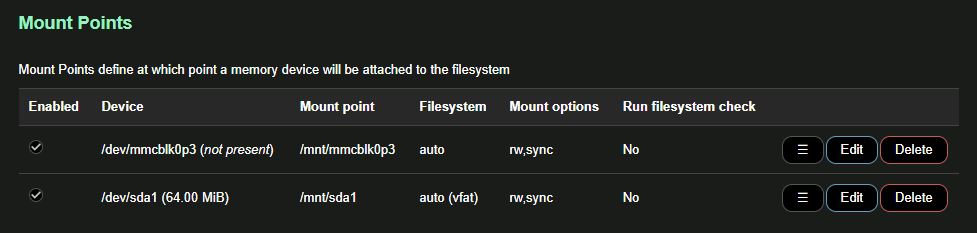

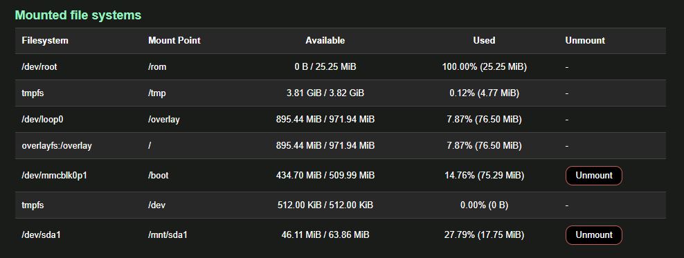

I was a little impatient, decided not to wait, booted from the Raspberry Pi OS and with gparted created an sda3 partition (decided not to touch the existing ones, just in case). And from 192.168.3.14 I then added another mount point and a network share, and everything is working now… It should have created it on first boot, no? I guess it’s an issue related to booting from the USB for the first time.
Yes, it looks like it’s specific to USB — on the next firmware release I’ll look at more options for the images and potentially add a choice of file system (ext4/squashfs) and one that’s optimised specifically for USB
