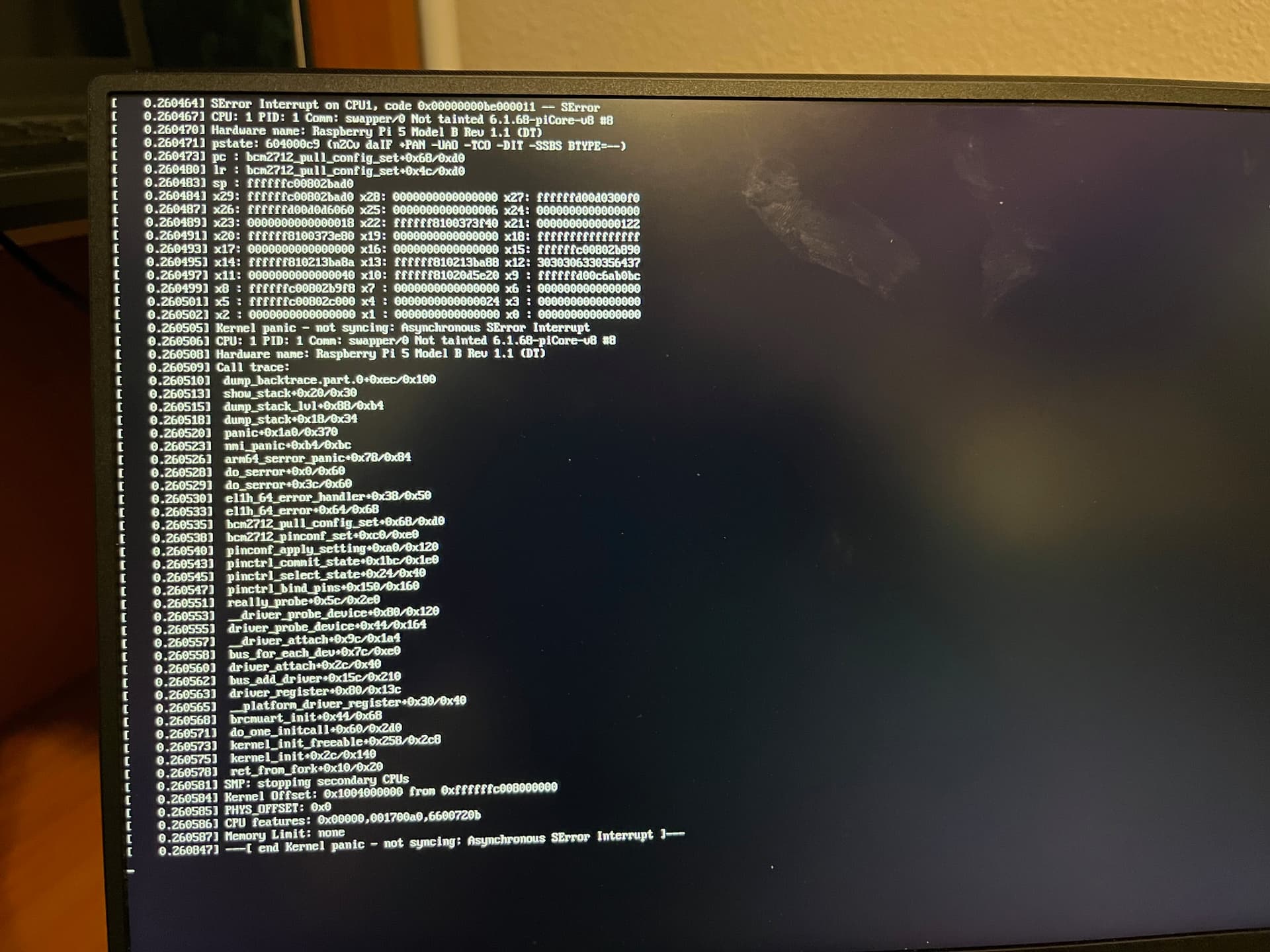

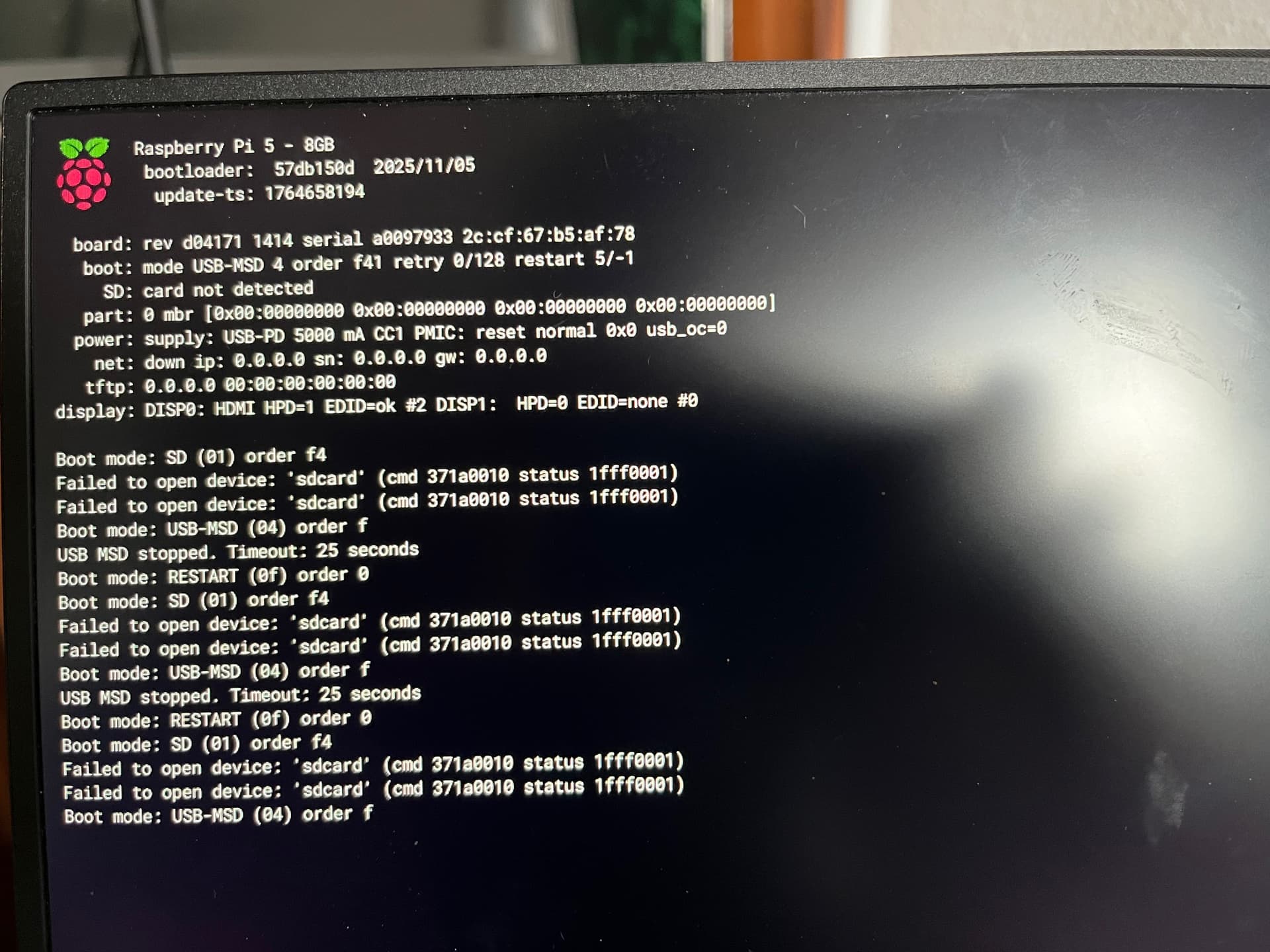

Kernel Panic on PI 5 / 8G / boot loader 57db150d 2025/11/05

Yes, must have been something unsound with my initial copy of download to sd card, to two different cards???
I downloaded the same image again, copied to sd and this time it booted ok. Just for sanity I copied the original download to sd again and now that boots as well.
Booth images are identical, so I’m not sure what went wrong.
