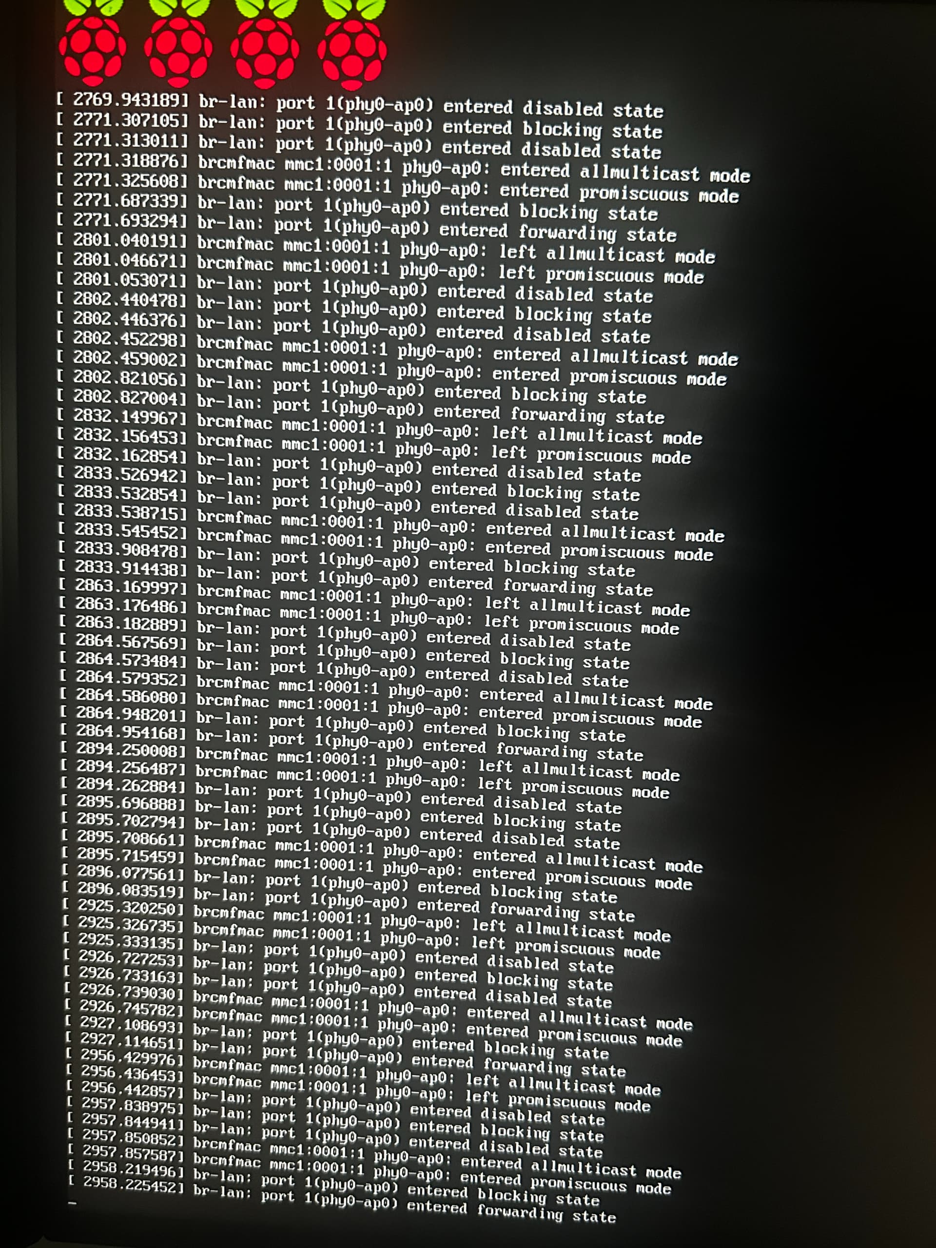

I was able to follow the setup and it works. but the wifi keeps disconnecting after a few seconds.
It fails, then i need to manually reconnect on my phone, and then it fails again…

Managed to re-create on one of my Pi 5 - so something going on there. Will provide a fix today.
There’s a script that is designed only for PiFi Kit that’s causing some instability on the image from a few days ago - will push a new image today
In the meantime, you can actually have it work perfectly on your current image by entering
rm /etc/sysp/pifi_apstatus on your shell and then rebooting
Thanks for the heads up, this image hadn’t been rolled out via showing an in-app update yet so great to catch this issue early!
I just updated to your new release and everything is working perfectly now.
