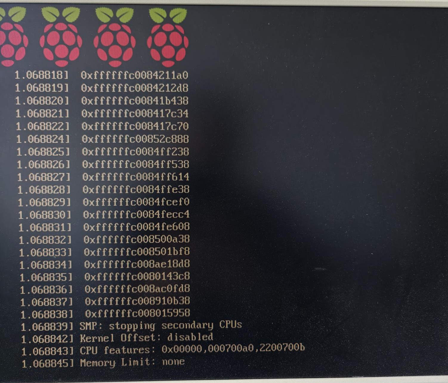

Same problem here. I bought a new pi 5 - 8gb and flashed the sd. The Pi stays about 5-6 sec in green light, a short 1 sec in red and again and again.
I ordered a display cable now to see whats comes out.
Ok, thanks, when you do see display if you let me know the bootloader version that’s helpful
I’m aware of the newer devices (2Gb/16Gb) had changes which needed newer firmware, but it’s always worked on Pi 5 (8Gb) and I’ve not been able to replicate that issue so far
That being said there’s a new beta firmware image coming out on Friday for Pi 5 so if that image is no longer compatible with a newly released bootloader then that will provide a fix
We also have a beta image just now but it’s lacking support for PiFi Kit (I’m not sure if you’re using that), but I’d probably use the image that’s available from Friday
thats all I got. After this screen it directly restarts.
