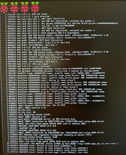

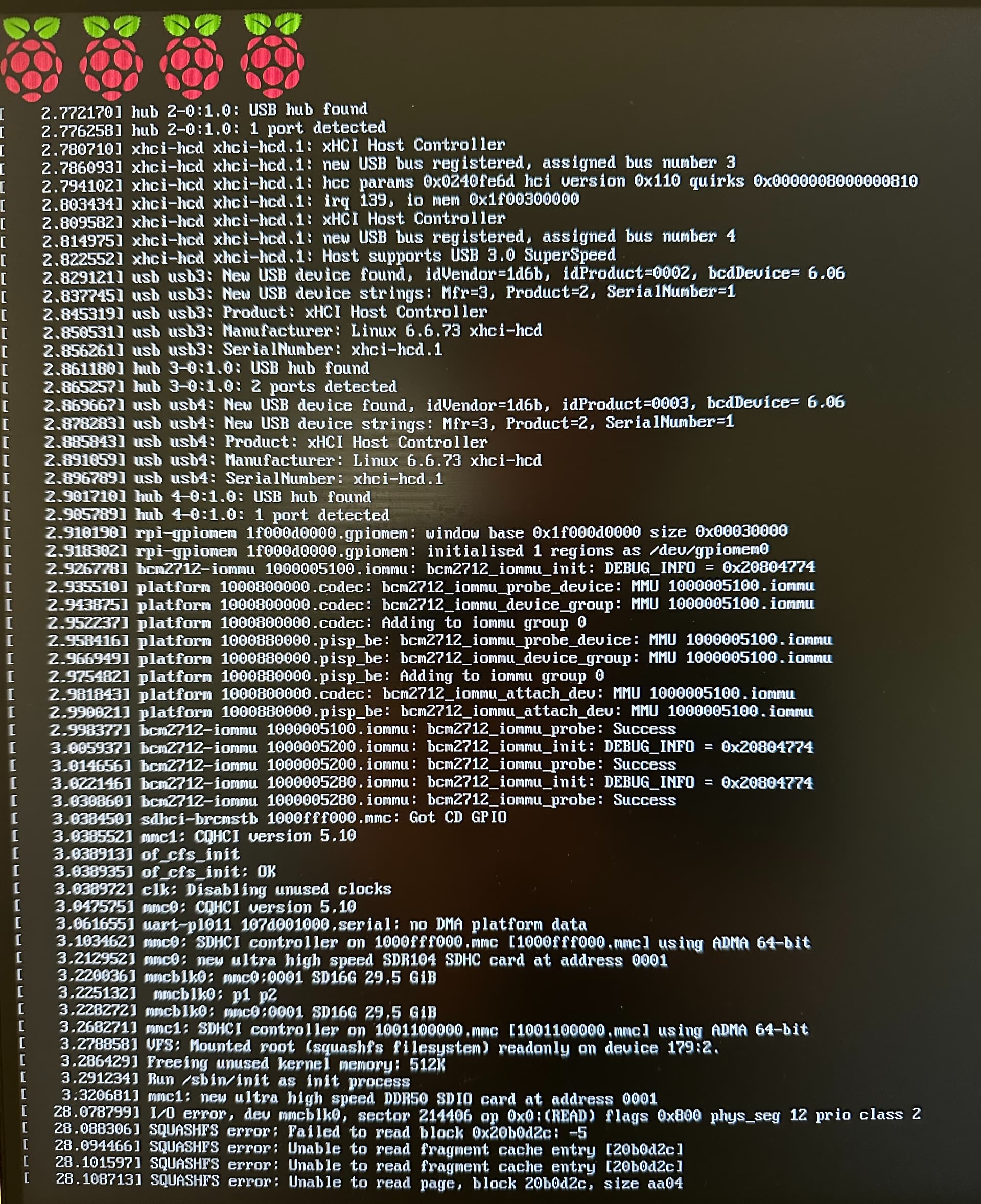

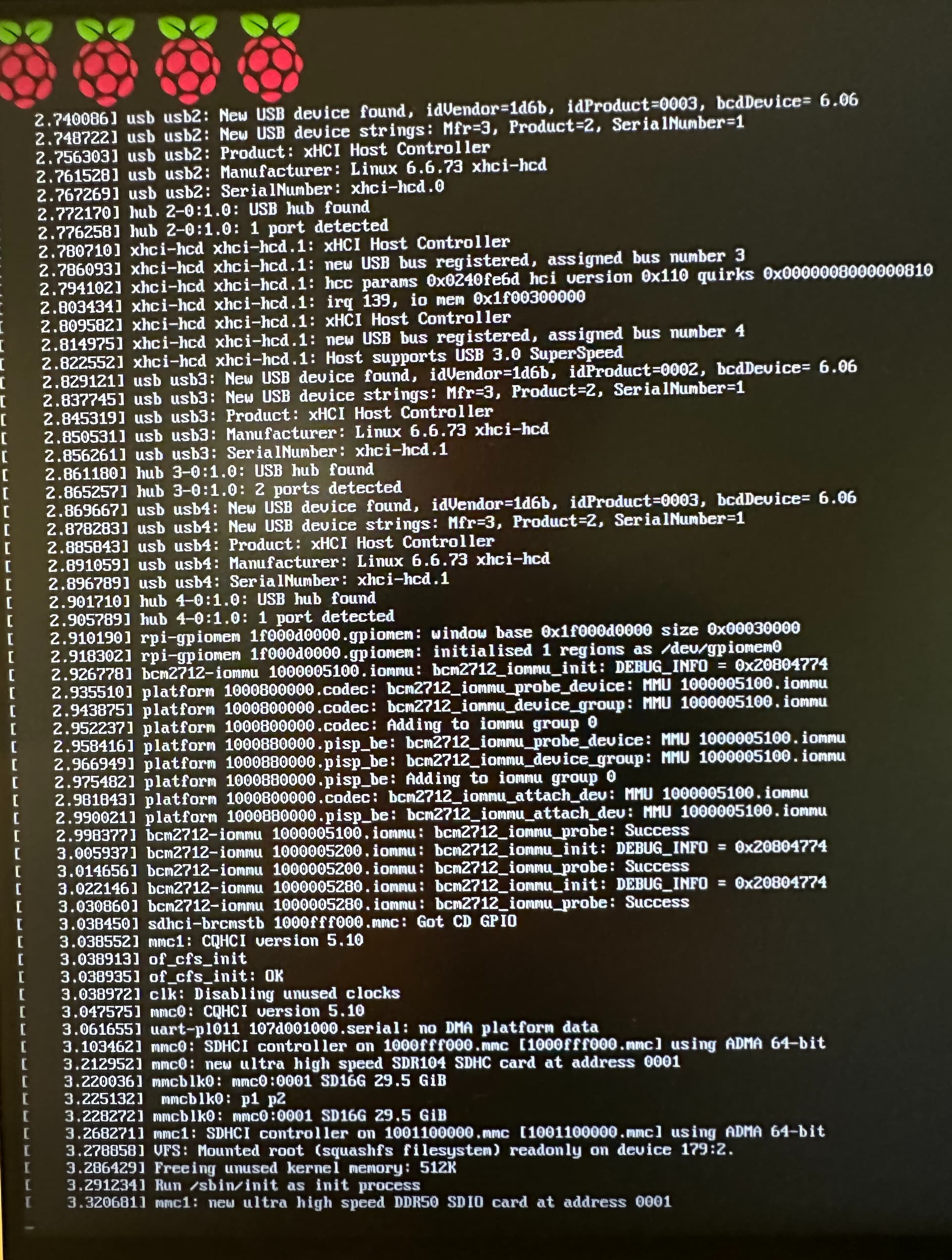

Been trying it out, havent gotten it to work. Here is the sequence of events that just lead to a loop of rebooting, hope this helps.

I do find that the PiFi Beta Firmware works fine though - I’ve tested on Pi5 16Gb although it seems your SD corrupted in the picture above. An .img.gz file (like the beta firmware) doesn’t always fully replace the partitions to allow recovery
  • I’d try flashing software that rewrites the partitions on your SD - something like piCore and booting it which will rewrite the old partition
  • Then flash PiFi Beta Firmware on the same SD (which now should be healed from corruption with it’s old partitions overwritten)
