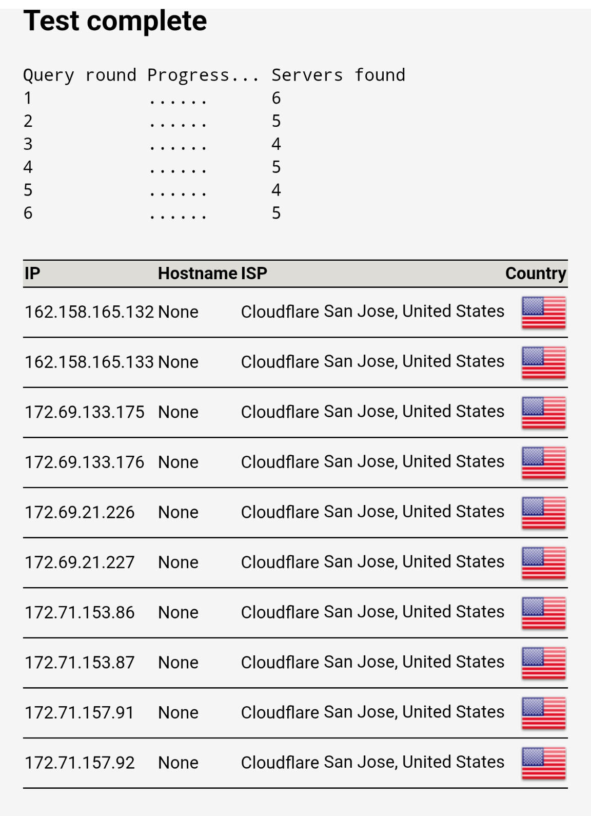

Almost working, but DNS issue. Before I was testing from my home Lan. This time I went to a Starbucks coffee shop nearby to test a real world scenario.
What’s working:
  1. I can successfully reach my exit node on my LAN. WAN traffic is showing the correct IP.
  2. I can access some LAN resources, but not all.

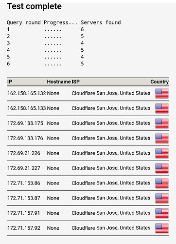

In tailscale dashboard I toggled override DNS and entered my own nameserver. This is what I should see when connected to my tailnet. Instead, I’m seeing random cloudflare DNS servers. (Please see pic) I assume these are default DNS servers in Pifi.
I also have the tailscale app on my phone. I tested same internet connection with the app (not on pifi) and the DNS resolves correctly. I see my DNS nameserver. No cloudflare DNS servers.
This is very close to working. Hopefully the DNS issue can be resolved.
Is this issue perhaps related to this bug? Similar issue with DNS.
So, if you have AdGuard enabled, and Tailscale is still using AdGuard as primary DNS resolver then that’s a feautre, not a bug
You should be able to exit your exit node (which works?) plus have adblocking via AdGuard
However, should you also wish to have your ISP/exit node DNS too - then you’d need to disable AdGuard - my recommendation would probably be to keep it on where possible
